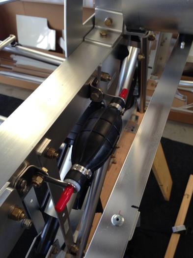

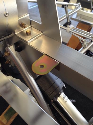

Date:  9-21-2015
Manual Reference:  LSA 2.6 & 4.2
Brief Description:  Primer Bulb & Brake Remote Reservoir Bracket
Another frustrating day of LSA/LSX manual conficts & confusion.
Seems that my delay in mounting the fuel tank (due to the back-ordered Fuel Tank Strap), comes with a hidden blessing:
There are several locations on the aft face of the top main bulkhead crosstube, that require drilling & tapping for miscellaneous brackets. This would have been a real challenge if the fuel tank was permanently installed. Even without the fuel tank, it proved to be a little challenging because I had previously installed the Forward Fuel Tank angle, which is riveted to the bottom of the Boom Tube.
So I had to work around the angle,, tough but doable.
Again, this could have been easily remedied if I had the correct manual, ahead of time. The LSX manual that came with my kit makes no mention of these steps.
So, I managed to install the Fuel Primer Bulb, and the BrakeRemote Reservoir mount bracket, per LSA Sections 2.6 & 4.2.
