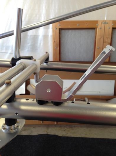

Moved over to the Throttle Assembly,,
Another LSX/LSA confliction regarding the Aileron Stops (er, lack thereof!)
The LSX depicts a "flat bar" pair of stops, mounted on either side of the center fuselage tube, whereas the LSA depicts a modified Channel Bracket, mounted below the Throttle Assembly.
Neither style of stop was included in the kit,,
AND, seems my center fuselage tube has a different hole pattern from the tube shown in the LSX manual. Another kit upgrade that failed to make it to the book. So if I want aileron stops (which I do), I must use the LSA version (channel bracket style), and longer bolts.
Another parts hold.
