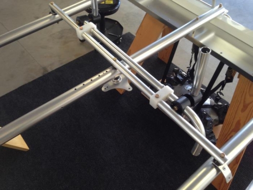

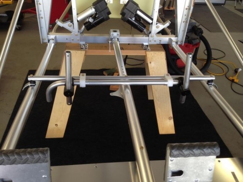

Started on the Cockpit Flight Controls. Managed to get as far as section 10.1, when I discovered that the called out drilled AN5-35 bolts, for the Control Sticks, were not included.
So,,
As I was making a note for my next Aircraft Spruce order, I went ahead and perpared a list of ALL cockpit control pivot points, and to replace all undrilled AN bolts, with drilled versions.
Just seems "right" to me :)
Another parts delay :(
I also stole a couple of pages from my RV building days, and used solid rivets in the bellcranks,,
Looks like Control Sticks,, Captain!!
