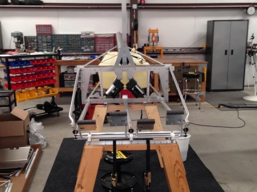

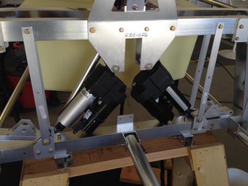

Landing Gear Actuators
Actutual installation of the actuators.
(SWIDT?)
To me, there seems to be a little too much play at the top bolt (AN4-26A), The nut bottoms out on the steel sleeve, so other than installing some washers in between the existing aluminum spacers, I can't see where this is contrary to the plans.
I will verify with PA (add this to my list!)
