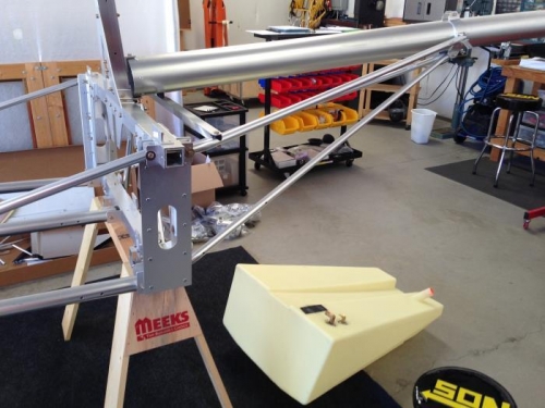

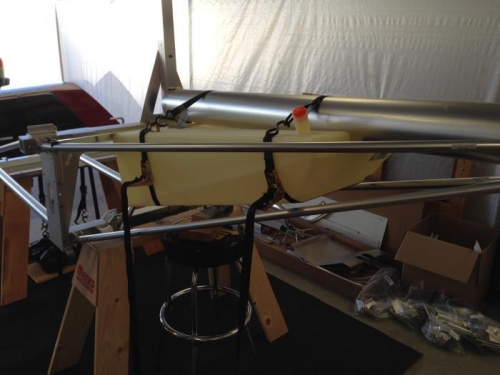

Brief Description:  Fuel Tank Install
As mentioned earlier, this is where I had to stop until I get some confirmation from PA.

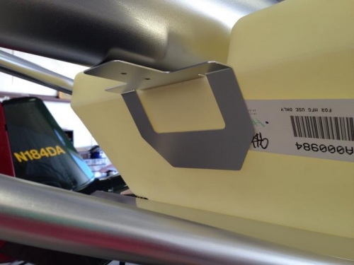

Seems they did include that rear tank bracket, shown in photo 3,, but no instructions.
I think I have it figured out, and with the help of some ophotos from a friend's LSA, I pretty much have an idea of how it all goes together.
There are still some missing parts in order to make this happen:
- There is a shim that gets installed on the top, center, forward corner of the tank
- There are some wood blocks that are used to support the baggage deck which attach to what was formerly the rear tank angle
- Additional spacers for that rear tank angle
- Foam spacers bewteen the tank and baggage decks
Anyway, I will call PA,, I heard a rumor that there are instructions that go along with the new tank, but I haven't seen them.
In the meantime, I will focus my attention elsewhere,,
