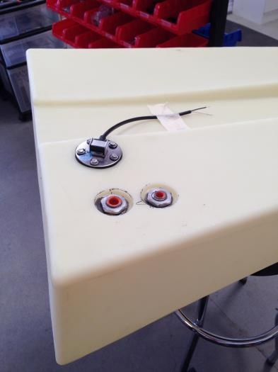

Brief Description:  Fuel Sender & Tank Prep
Hit a snag today.
Seems that the maual has not caught up to the newer, LSA style 23 gallon tanks that PA now ships with all kits.
There is no mention of this in either of Sections 3 or 4.
The tanks are geometrically different, as are the ports.
The front tank angle will work as described in Section 3: 12.1. But anything beyond that will not work as described in the manual.
Additionally, I later learned that the instructions in Section 4 regarding the modification to the fuel sender, are no longer applicable and we are to follow the instruction sheet that comes packaged with the new sender.
Geez,, would have bee nice to know that ahead of time!
