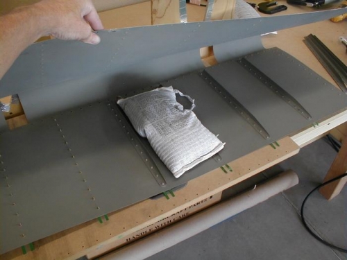

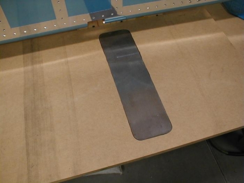

I fixed the problem with the back rivet plate by inlaying it in a piece of MDF. After priming and prepping all of the parts, I back riveted the stiffeners in place. Then went about the process of riveting the spar assembly into the skin.
Inlaid Back Rivet Plate to prevent another OOPS
Back Riveting Stiffeners
Riveting Spar to skin
