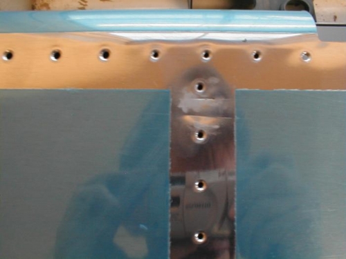

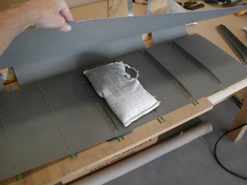

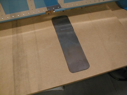

I began riveting the stiffeners to the right skin. I let the last rivet in the row get off of the back plate and tried to shear the skin off. Called Vans and ordered another skin. $85 i didn't have to spend, but oh well. I inlaid my back rivet plate in a piece of MDF, problem solved. Works much better!
OOPS
OOPS
The Fix
The Fix
Works much better
Works much better
