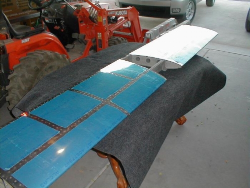

Brief Description:  One side done! Started on the other one.
I riveted the skins to the spars and ribs using my 3x rivet gun and a bucking bar. I used some card stock from old hard copies of invoices from the shop, cut to fit in the spar to protect the primer from the bucking bar, worked like a charm. I squeezed the end rib to skin rivets. I love that pneumatic squeezer! Does anyone build a 24" no hole yoke? Clecoed the other assembly together and riveted it to the spar as well. The HS on this thing is huge! I riveted the rear spar assembly in with the squeezer. Some of the rear spar to ribs use blind rivets since there is no access to buck them. The HS is Done!!!
Right side done, left side clecoed ready to rivet!
