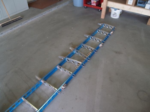

I clecoed the spars, main ribs, and nose ribs together and matchdrilled all the holes. The assembly is so large it's hard to take pictures of. Next I seperated the assembly into right and left and began clecoing and matchdrilling all the ribs to the skin. The nose ribs are a pain to get in, I found it easier to cleco them in laying on the bench and then installing the skin into the jig much easier.
Entire HS assembly clecoed and match drilled

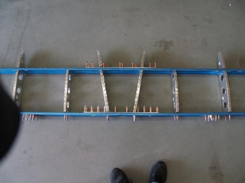

another view
another view

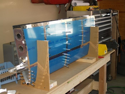

Right skin clecoed in place and match drilled
