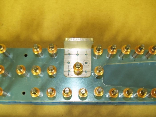

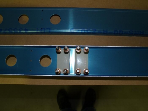

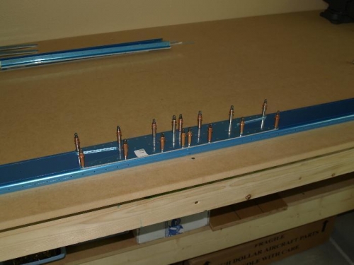

I began by clecoing together the front and rear spar halves along with their respective doublers, then I matched drilled the holes through the doublers and spars. I fabricated the attach angles by laying them out on the raw stock supplied in the kit and cut them out on my bandsaw. I layed out the rivet holes and clecoed them into place on the spars. I then drilled the remaining holes into the spars and doublers which will be used to rivet these brackets in place. I continued by clecoing and match drilling the elevator hinge brackets on the rear spar.
Front and rear spars clecoed with angle attach brackets
Close up of angle attach bracket
Elevator Hinge brackets clecoed and match drilled
