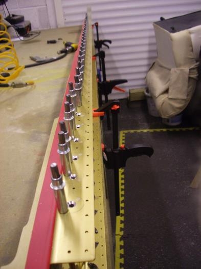

Brief Description:  LH wing spar - tank nutplates
Repeated the co-drilling, countersinking and riveting of the tank attach nuptplates on top and bottom of the left hand wing spar. When completed, Alodine corrosion protection once again applied via cotton bud for the exposed #8 screw nutplate countersinks.
Ready to rivet.
Ready to rivet.
