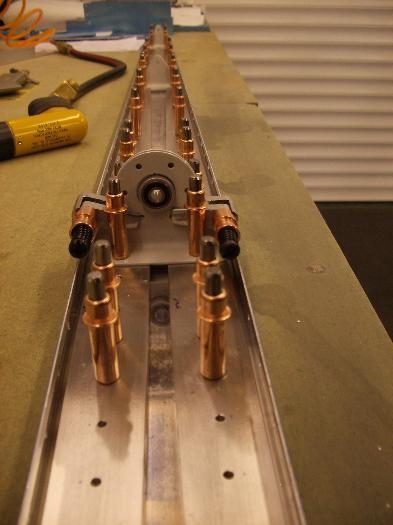

Drilled/Match drilled rear spar including hinges and centre bearing. All rear spar tasks complete except final deburring and priming, then rivet assembly.
Began front spar; match drilled reinforcing bars and shaped upper reinforcing bar using vixen file, scotchbrite wheel and pad.
