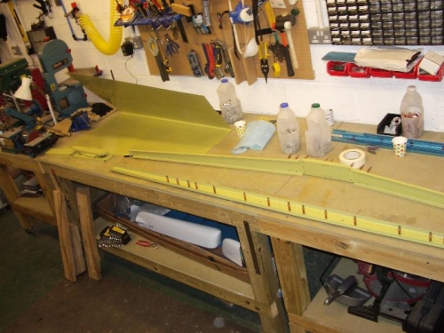

The secret is clearly to work the deoxydine in with the Scotchbrite pad, then wash off with more water than you'd think.
The LH horizontal stabilizer skeleton and skin is now completely primed. The proof of the pudding will be when I prime the right hand side, using the "new" technique from the start.
