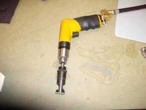

Countersunk vertical stabiliser stiffener
After carefully double-checking the lans to ensure that I cut metal from the correct holes, on the correct side of the compenent, I used the cage and a #30 bit to countersink the appropiate holes to match the dimpled holes in the VS rear spar.
Countersink cage on air drill
