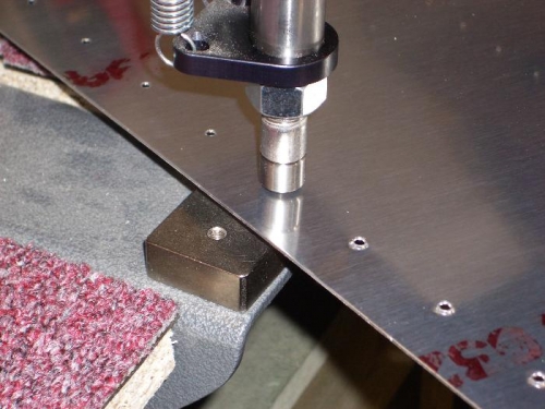

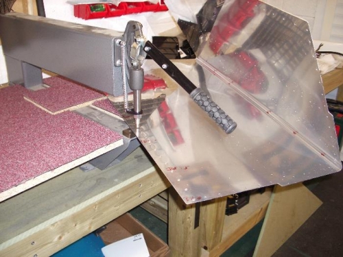

My wife and Mother-in-Law were watching 'Poirot' on the TV, so I esacaped to the Garage for a while to finish deburring the VS skeleton and skin, followed by firing up the compressor to use a dimple die set in the pneumatic squeezer to dimple the flanges of the spars and ribs, as well as some of the holes where the spar attaches to the spar doubler. These holes take rivets that need flat heads because they sit where the VS will eventually butt up against the fuselage.

Dimpling VS skin in DRDT-2
Close up of dimpling
