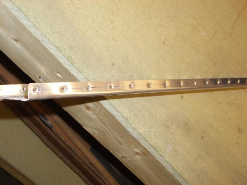

Brief Description:  Began dimpling HS sub-structure
Today was spent deburring holes, edge finishing parts and finally dimpling the left HS skeleton sub-structure (using a pair of vice-grip dimpling pliers).
The dimpling was even more RSI-inducing than removing or installing a sub-structure's full complement of clecos. Ow.
I also made a start on dimpling the HS skin, using the DRDT-2 dimpler. Much easier, thankfully, and the carpeted dimpling table is strangely satisfying to use.
I must be easily pleased...
Dimpled spar flange
Dimpled spar flange
