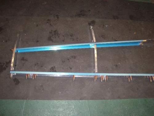

Cut HS404 rib flanges & check fit assy
Cut HS404 rib flanges to fit over Horizontal Stabilizer forward spar stiffening bars.
Rough cut with nibbling tool, then back to marked line with Scotchbrite too, finishing off with micro files.
Check fit left hand HS by clecoing parts together into check assembly.
HS404 drawing
Check fit assembly
Check fit assembly Left HS
