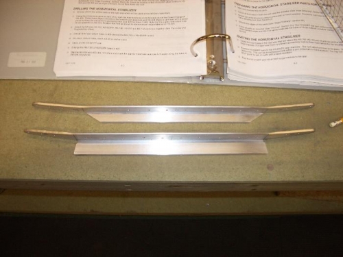

Began to bend HS fwd spar reinforcing bars

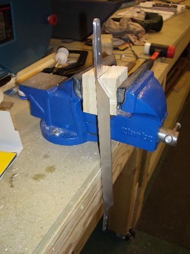

Marked 6 degree angle on MDF.
Put upper reinforcing bar in vice, held at bend line between two wood block.
Bent using small rubber mallet - knock, check angle, knoock, check etc.
First bend of 4 completed.
Bend 6 deg between blocks of wood
Both bars now bent
