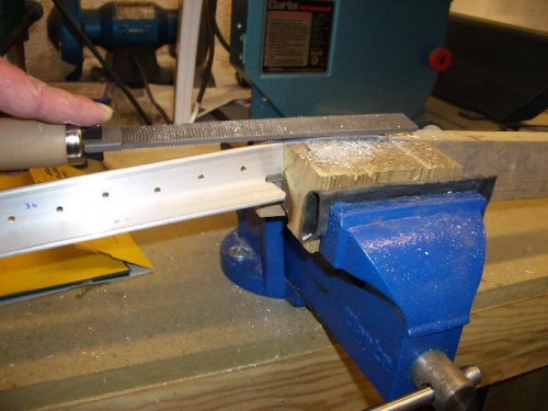

Shaped with vixen file, then Scotchbrite wheel then sandpaper block, finishing off with a Scotchbrite pad.
Vixen file shaping HS-710

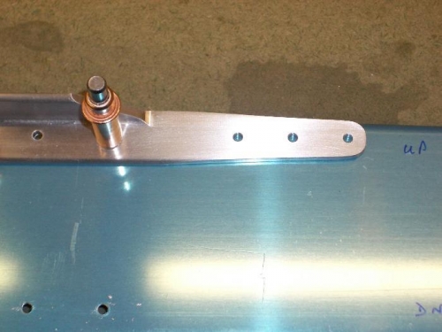

Final shaped part

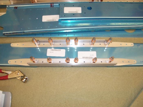

Reinforcing assembly - HS fwd spar
