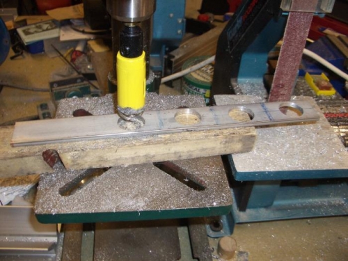

Then onto preparing the tie downs that provide somewhere for two forged rings that end up under the wings to stop the aircraft blowing away f it ever has to be parked outside in a gale on some of the loing trips I plan to do in her. :-) The first part was to fabricate 4 soacers, and this is done from a supplied stock aluminium bar; the first thing to be done is to remove some lightening material, and this required use of a 1" hole saw I'd recently bought. Required a fair amount of Boelube and the bar got pretty hot, but now there are 4 neat 1" holes and the next job is to saw them into 2" lengths. The bandsaw is playing up at the moment and won't cut straight - so that will need fixing first. Maybe I'll treat it to a new blade at the same time.

1" hole saw in use
