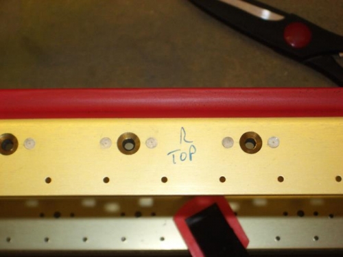

Further drilling and countersinking for the RH wing nutplates on the upper side of the spar. Riveted nutplates in place, following countersinking for the flush head rivets that will lie under the skin when that is attached.
REady to squeeze first nutplate rivets

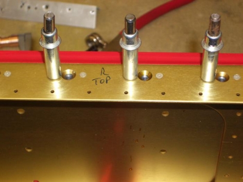

Both rivets squeezed; note Alodine'd c/sinks
All tank nutplates rivetted in place
