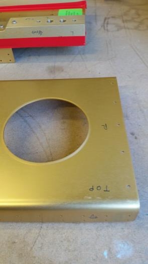

The first thing to do is to remove the protective plastic covering from the wing spars, put them on the bench and give them a good looking over. A primary task here is to mark them up properly: Whilst Van's supply them well identified as Left and Right, the important thing is to make sure they are clearly identified with the correct orientation. As the plans say: "You do not want to build a wing upside down." - that's a definite "Yup" from me.
The spars are an assembly of gorgeous aluminium prepared with an Alodine anti-corrosion treatment that gives them a lovely bronze colouration. They're very beefy (as you'd expect for an aerobatic aircraft), but surprisingly light all the same. The key parts of the spar assemblies are attached with much larger solid rivets than anywhere else on the aircraft, and which are quite possibly beyond the capabilities of my riveting equipment so it's good to have them pre-constructed at the factory. I've a lot of machining to do on them, and don't want any swarf to drop between the assembled parts, so the first step after a good inspection is to tape up the joints to protect against that. Electrical tape seems the prefered tool for the job amongst other builders, as it leaves less residue than ma

Orientations marked up
