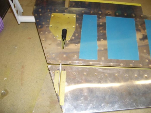

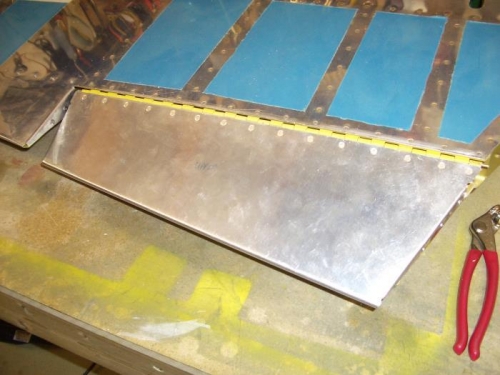

Once I was happy with the installation of teh piano hinge, I rivettted it in place one side at a time, with in each case the hinge pin sinstalled in the half-hinge to ensure it maintained its alignment under the influence of the rivet squeezer.

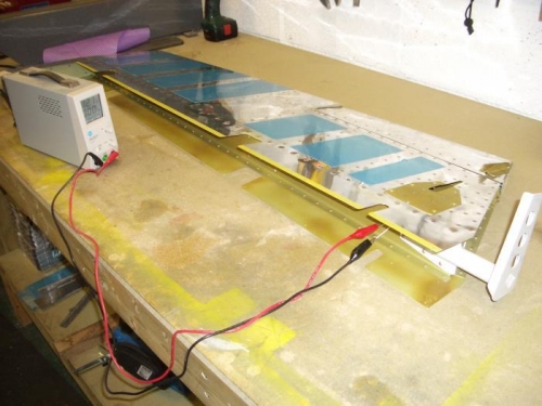

Now it was time to start thiking about the inatallation of the servo that drives the trim tab, so I test fitted that, and attached electrial power for the first time with servo i elevator to start to check clearances.
Looking good so far, so soon we'll see how it looks with the actuator arm in place.
Trim tab hinge riveted in place

Electrical power to servo
