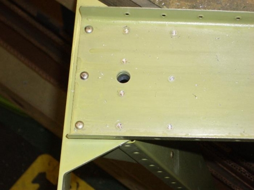

So, did you spot my idiotic error by comparing the drawing in the last entry with the photo of what I actually did?
Yep - I riveted the lower reinforcing plate (R-606PP) to the *wrong* side of the spar!
A particularly bone error since that was now riveted in conjunction with 6 other parts, meaning that correcting the error would be time-consuming and requires extreme care not to drill into structure when drilling out the seventeen (Doh!) rivets involved.
Hey ho - a stiff self-talking too, followed by a couple of days to calm down, then out with the rivet removal tool. One positive point is that all were dome-headed rivets which means that a positive location on the rivet could be achieved with the removal tool to ensure that I only drilled rivet, not underlying structure.

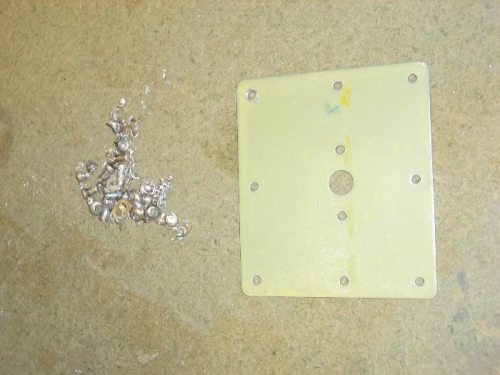

The heads came off easily enough, and with a bit of "fettling" out came the formed rivet shanks.
Next session, I'll refit the parts in the correct order, double & triple check that - sigh - and re-rivet.

That reinforcing plate is on the wrong side of the spar.  See taht skin and flange holes don't line up

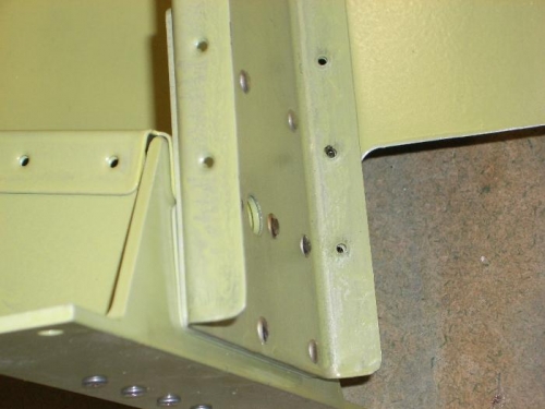

7 rivet heads removed - ready to drive out rivet shanks
Freed up reinforcing plate, and remains of drilled-out rivets.
