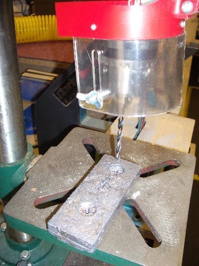

Having received my #10 drill overnight (thanks to fast work by Diana Pengilly of Gloster Air Parts), I drilled out the lead weight for the rudder counterbalance, machine countersunk the weight, and match-drilled the relevant rudder rib (R-912).

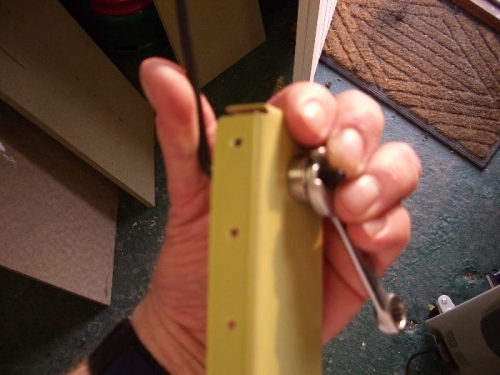

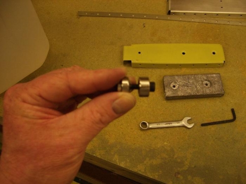

Then, a new tool for the project - the #10 dimpler, which rather than pressing the dimple into the aluminium uses a male and femal die held together on a screw which makes the dimple by pullig the dies together with a spanner and allen key on the screw thread. Simple and satisfying.

#10 drilling lead counterweight
#10 screw dimpler in use
#10 dimpler detail
#10 dimpler detail
