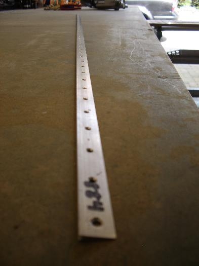

Brief Description:  Match drilled rudder TE & c/sunk TE wedge
The trailing edge of the rudder has the two skins coming together at a triangular section aluminium wedge to ensure straightness and rigidity.
The skins are dimpled, and the dimples sit in to counterinks either side of the aluminium wedge - so, out with the countersink cge and we countersink away!
Countersunk rudder TE wedge
