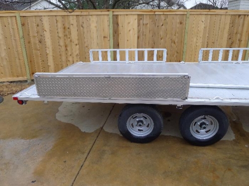

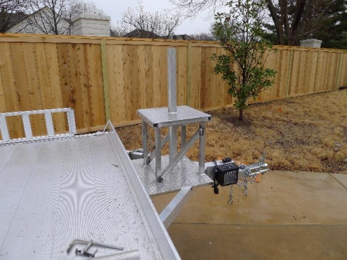

Photo 1 is the modified loading ramps. I welded 1/4" diamond plate to the existing ramps so that the wheels of the ship could roll up the ramps. Photo 2 shows the blade support "hook". The blade clamp will slide over the long horizontal portion.

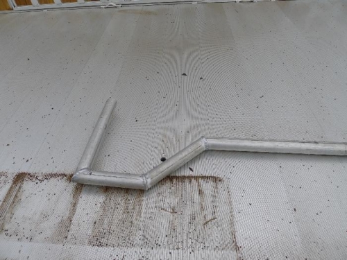

Photo three shows the support for the blade support. I welded the cross braces in between the legs primarily because I am going to mount a winch on the top for pulling the ship up the ramps.
I will need to have the ship on the trailer before cutting the blade support to length. I also need the blades on the ship in order to make the rear blade support.
