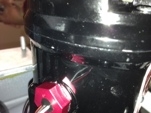

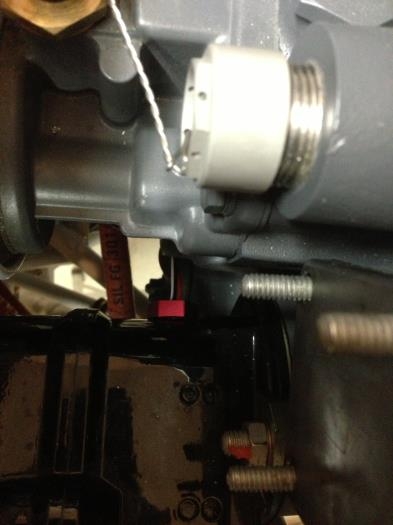

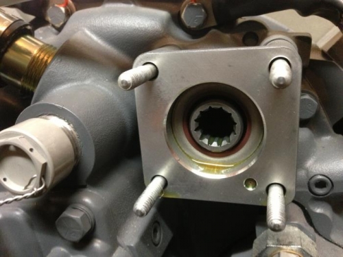

Installed into right magneto with Loctite 242. Installed SD-20 backup alternator with Permatex gasket sealer to 70 in-lbs
RPM sensor on right mag
SD-20/Accessory pad
