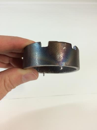

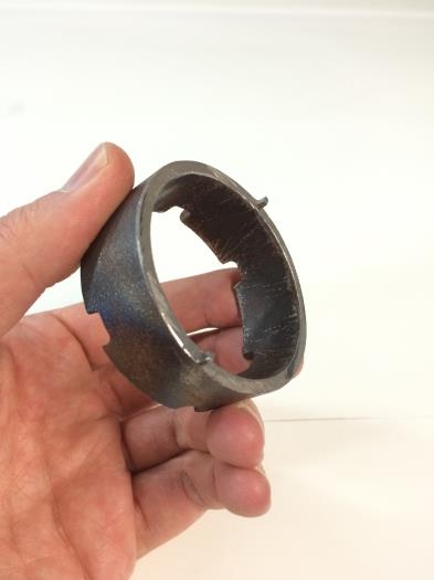

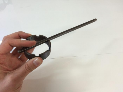

Brief Description:  Vent tool
Here's a tool made to engage the ring on the back of the vent after the overhead console is already in place. It worked like a charm. With the ring positioned by hand, install the steel rod into the notches and turn. Re-position the rod...and keep turning.
