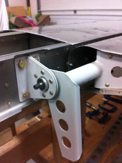

Shims were fabricated to allow for the HS attachment to the tailcone.
Elevator installed on HS

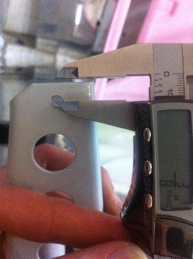

Edge distance short. Van's stated ok due to steel structure
