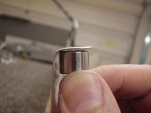

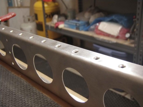

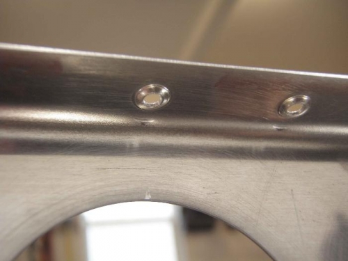

After a number of dimples in the front spar of the rudder, I noticed a small bump where the flange becomes the web. From the pictures, you can see the problem. I'll either need to shave the dimple die or order a smaller set. When this problem is resolved, it'll be time to prime.
Dimple die impacting inner fold

Impact area seen as a polished area
Small bumps in spar due to dimple die
