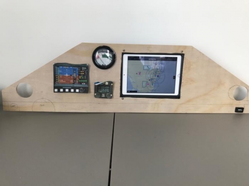

Brief Description:  Lift reserve and USB port
Installed lift reserve indicator (upper center panel) and USB port (lower left panel).
The lift reseve is a magnehelic gauge. When installed in the plane, I'll need to perform in flight tests to determine the actual color arcs for stall ranges, etc.
Don't know if I'll need a USB port, but rather install one now then find out in need one later. I'm sure I'll be glad I did.
