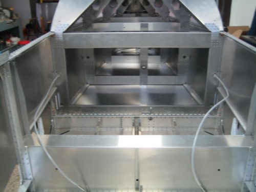

Installed rudder cable in fore fuselage. Drilled 1/8” pilot hole in SNX C03-05 and standed paint on SNX C03-06 to ensure easy and smooth fit. Will help with push rod assembly.

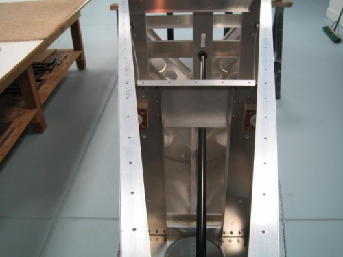

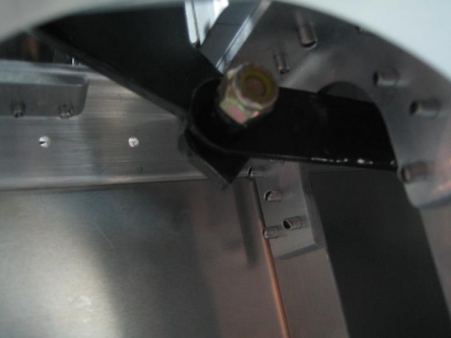

Installed pushrod and rudder cables.
Note: If you take the easy way and slide the two pushrod pieces together, then drill the holes for the AN3-12A bolts you can’t pull them back apart! I got it to work but wish I would have drilled small pilot holes and then taken apart, then up-drilled when unassembled.
Rudder cables installed
Elevator pushrod attached
Elevator pushrod installed
