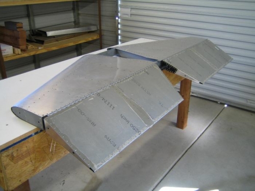

Brief Description:  Completed Deburring and Riveted Left Elevator
Completed Deburring and Riveted Left Elevator.
Elevators assembly complete! Hinges lined up perfectly!!!!!
Note: I used just a small amount of oil on the hinge connecting rod/wire and was able to push each one in without undo effort. For the last 4-inches I did need to place a block of wood against the end of the wire. The last inch required a few light taps on the block with my mallet.
Completed Elevator Assembly
