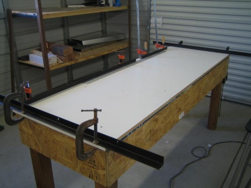

Brief Description:  Drilled elevator root rib holes
I made a jig to square the elevators to one another and then positioned both elevators and the completed elevator root assembly in place. I then positioned the yoke on the centerline and drilled the root ribs. They were not an exact flush fit with the skins, but the design allows for a bit of flexibility here. After clecoing rib roots to skins, I was then able to mark the inside of the elevator skin where it extended past the rib and trim and file the skins so they were flush with the ribs.
Elevator Jig
Elevator Jig
Elevator Jig
