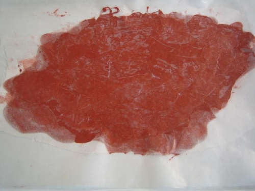

Push rod boot
Fabricated material for pushrod boot by placing fiberglass cloth on wax paper, then putting RTV on fiberglass, then another sheet of wax paper on top.
I then used a rolling pin to smooth out the RTV and press throughout the fiberglass cloth. Worked great!

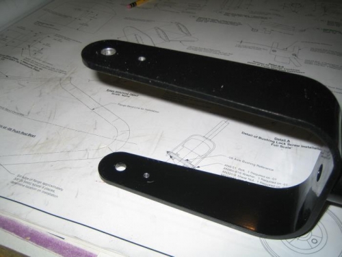

Also drilled and worked on nose gear while it dried.
Making high temp boot
Nose gear fork
