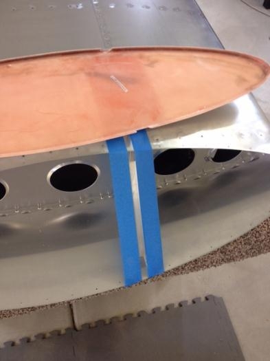

Big day, rarely do I get to put 6hr in. Also very productive. I figured out how to locate the holes on the wing tip angle bracket by using painters tape to locate both edges of the angle bracket. Then when I put the fiberglass wing tip in place, I could easily identify the centerline of the tip bracket.

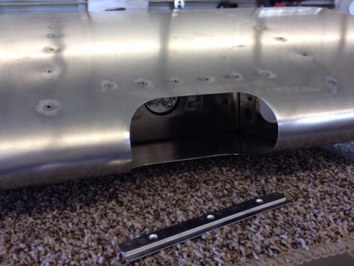

I was able to complete landing lens cutout.
Taping edge of wing tip angle bracket
Locating centerline of wing tip bracket
Completed landing light lens
