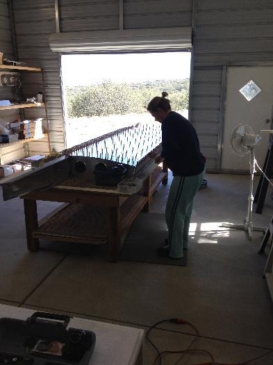

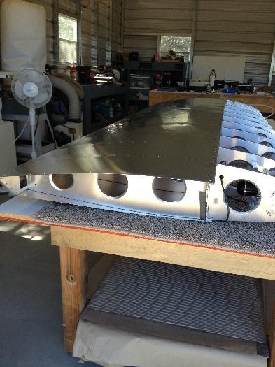

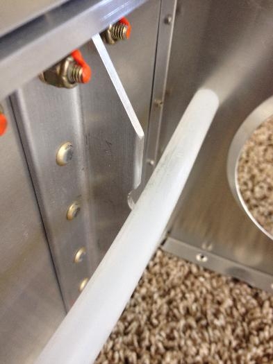

Installed top skin with Maria's help. Always goes faster to have two people install rivets!!! Also cut rounded notch in main spar stiffener to allow electrical wire conduit to have a straight run and not have a wear point. This was at Ken Hetge's recommendation when he inspected the wing.
Ground down and polished all installed flush rivets.
