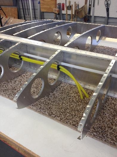

Completed installation of landing light in right wing as well as wire conduit (1/2" flexible PVC tubing) and Pitot tubing.
I installed a spreader (see Image 1) to keep the ribs at the proper rib spacing when installing the landing light so the ribs maintain the proper spacing so they line up properly with the skings are installed. (It worked perfect when I went to rivet the skins in place

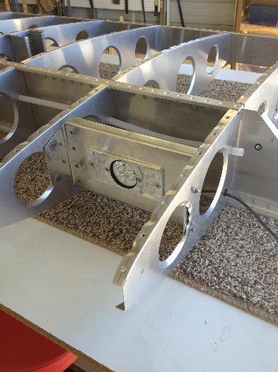

Left wing light bracked
Completed light bracket

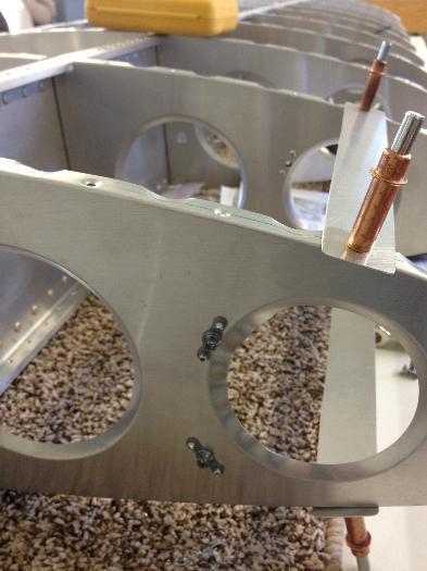

Conduit and tubing
Conduit and tubing
