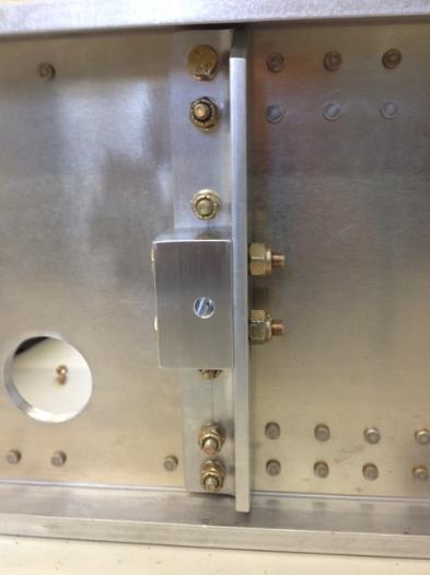

Brief Description:  Completed drilling 1/4-inch holes for main spar

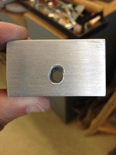

Completed drilling updrilling attach blocks. I saw on-line where some people dulled the point cutting edge of the 1/4-inch bit so it wouldn't wander in the pilot hole. Unfortunately I didn't do this and the foreward blocks (I drilled the holes from aft to foreward). Fortunately a majority of the hole deviation occured in within the forward attach block, so I was able to rebuild that block. (I hate doing rework!)
Aft attach block
Aft attach block
Foreward attach block
