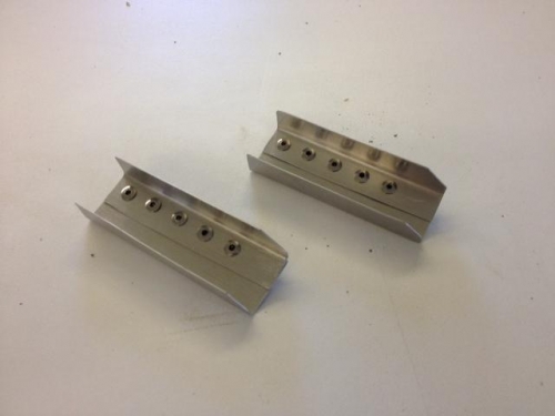

Completed W04-09 x2 Channel Assembly
Made jig for aileron drive rib assemble by clamping angle iron to the workbench and placing marking tape to locate rib tip in relation to the end of the assembly. This worked really well as it allowed me to quickly locate the counterweight plate on the rib, hold secure with one hand and drill with the other. All four assemblies came out perfect!

I started drilling the holes in one of the lead counterweights. The plans say step drill and only drill ½ way through for good reason. The lead is soft and really grabs the drill bit, so you need to keep moving the bit in and out of the hole to clear the bit.

Counterweight Channels
