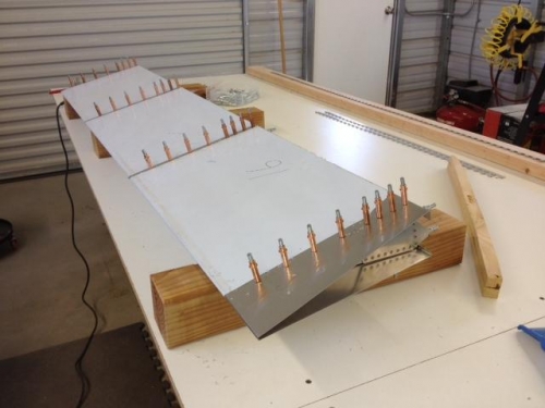

Drilled, deburred and completed right flap assembly.
I can tell my skills are improving. The flaps were completed very quickly.

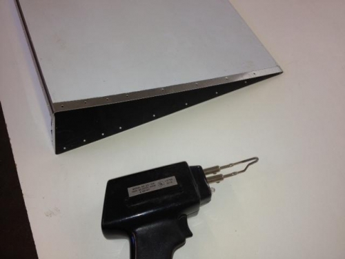

Last night I read about the a great way to cut the protective plastic on the skins. Using a razor will scratch the skins, but using a soldering gun makes a nice melt line that the plastic will rip to.
Right flap ready to rivet
Cutting the protective plastic
