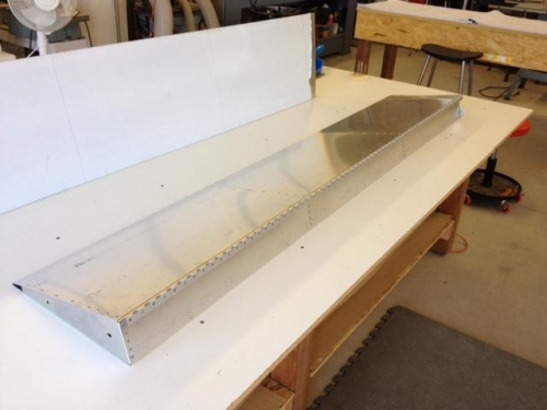

Deburred flap ribs and skins, riveted and completed left flap.

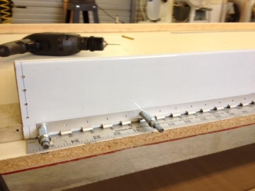

Similar to the elevator flap hinges, I used a steel ruler to position the flap hinge.
Learned this trick at the Sonex builder workshop – hinge ends up laser straight!
Drilling hinges on left flap - using steel ruler as guide

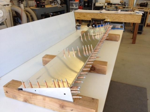

Right flap clecoed ready to rivet
Completed left flap
