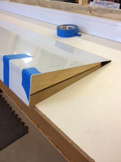

I cut the flap skins the same way I did the ailerons – using my band saw and a support block within the flap skin. Make sure if you use this method you cut fat of the line and file back to the line.
I used a Dremel tool with cutting wheel to make the other flap skin cuts.

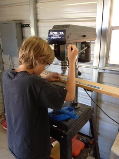

My 13-yr old son Adam drilled all the holes for the hinges for the flaps and ailerons using the jig I made for the elevator hinges.

Support block in place - ready to cut flap skin
Adam drilling holes in hinges using jig
