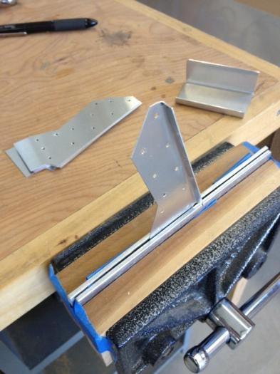

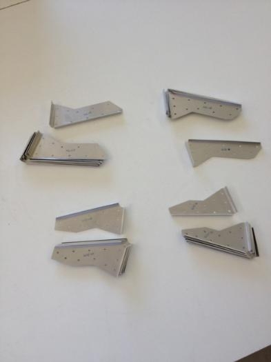

Bent all rib gussets
Built bending brake from bench vice. Taped to 1/8" x 1" x 6" aluminum flat bar to vice. Gussets are thin enough that I could bend them by hand and the aluminum pads worked great to hold the gussets.

Home made bending brake
All gussets complete
