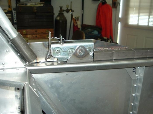

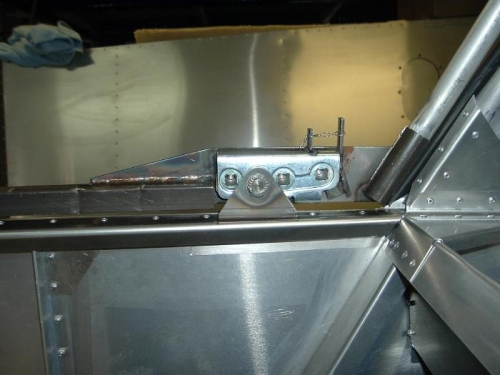

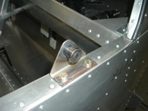

Aligned the striker studs with the latch on the canopy frame rails. The frame rails had to be bowed slightly at the latch end to match the curvature of the the fuselage. This was done by kinking the square tubing with the help of a vise and three bolts as shown in the photo guide.
Striker stud.
Striker stud.
Latch left.
Latch left.
Latch right.
Latch right.
