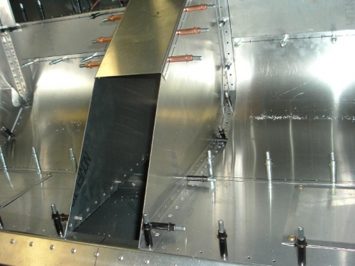

Brief Description:  Seat belt attachments.

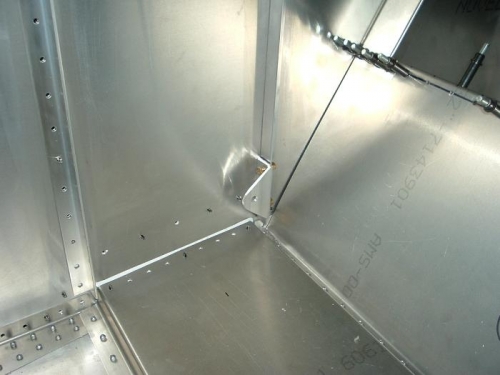

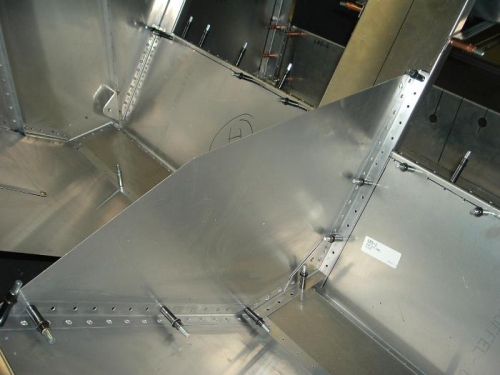

Worked on the seat belt attachment points today. The outboard brackets are made from 1 x 1 1/2 x 1/8 angle. They are bolted to vertical angles that run from the upper longerons to the landing gear weldments at the bottom. The inboard brackets are .060 material that is doubled with the side of the center arm rest, (seen in image 2 & 3 ).
Outboard right seat.
Inboard left seat.
Inboard left seat.
Center Arm rest.
Center Arm rest.
