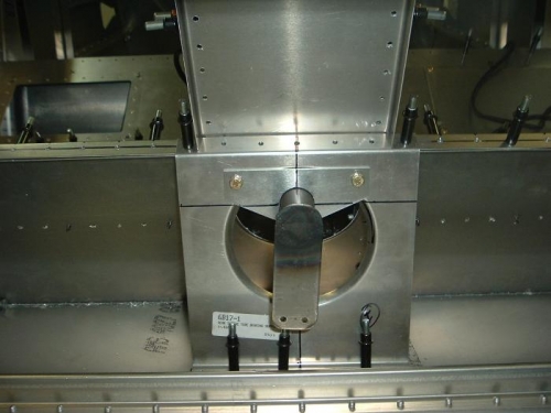

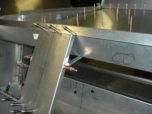

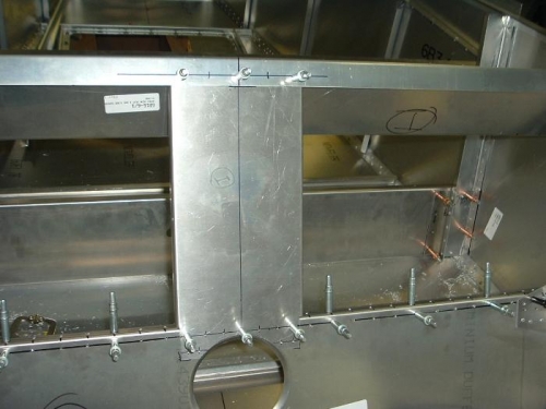

After adding the doubler to the top of the seat back channel, I started fitting the center seat back channel. Image 1 shows the trimming needed at bottom to clear the lightening hole in seat back channel where the torque tube will live. Image 2 is seat back with 2 "L" angle braces that give sopport to baggage floor. Couldn' t resist putting the torque tube in the bearing support for the image 3 shot.
Trimmed & clecoed.
Trimmed & clecoed.
Braced.
Braced.
Bearing support under center seat back.
