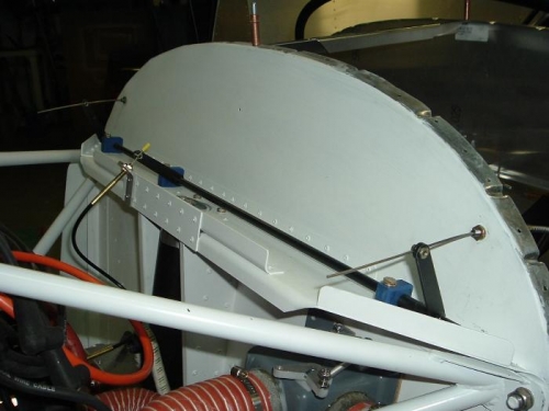

With airbox mounted,I began setting up the dual throttle controls. Located the throttle cross shaft on the shelf of the firewall as far aft as I could to clear the front gear leg should it raise that high. Found the insterment panel to be too flexable to support the throttle knob well, so I added the small angle and an adel clamp. This also seemed to smooth out the movement of the push-pull control.

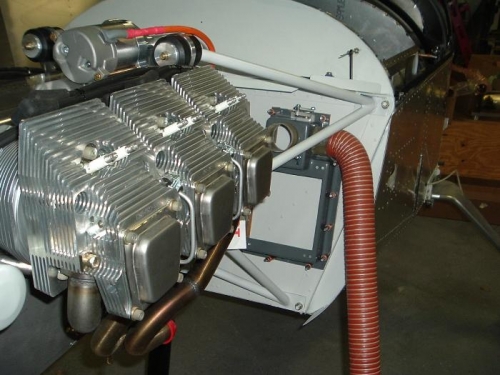

Rough fit of the NACA duct.
Throttle cross shaft.
